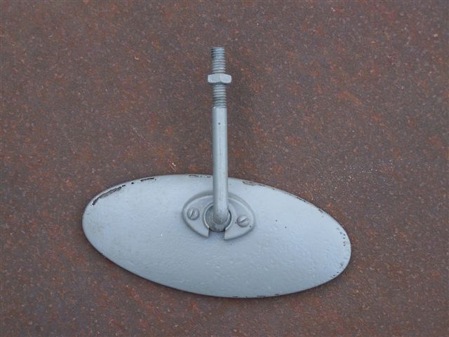

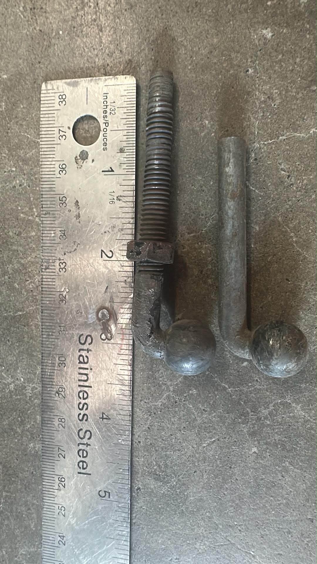

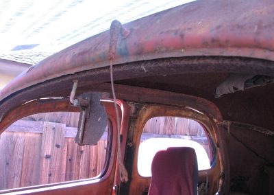

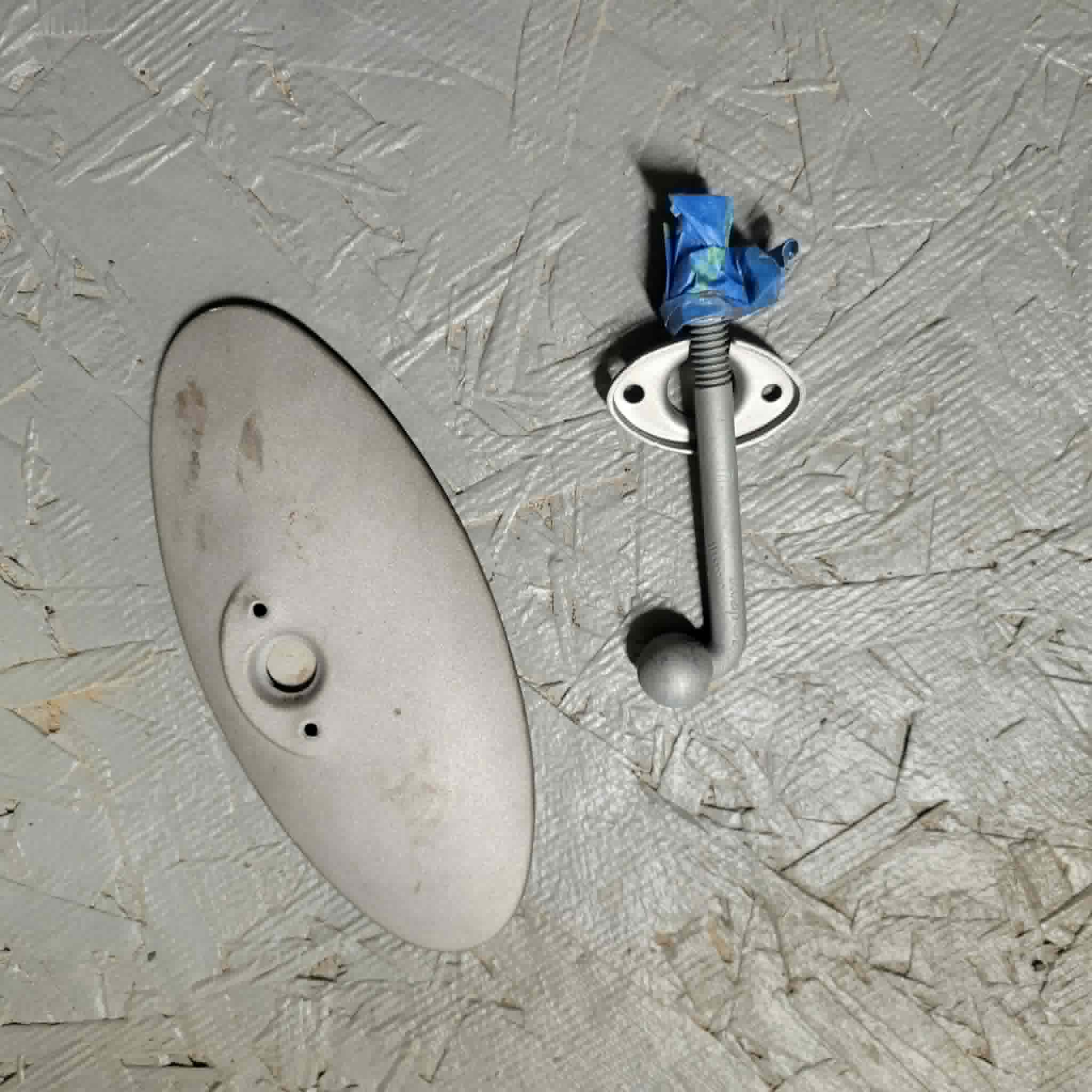

The pictures below of the 1937-1940 Mirrors and stem bolts including measurements are from Rob Pridge’s collection of Willys parts in British Columbia, Canada.  A set of pictures of the 1941-42 Oval Rear View Mirror from  my former ’38 Willys PIckup.

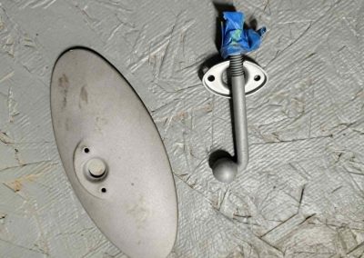

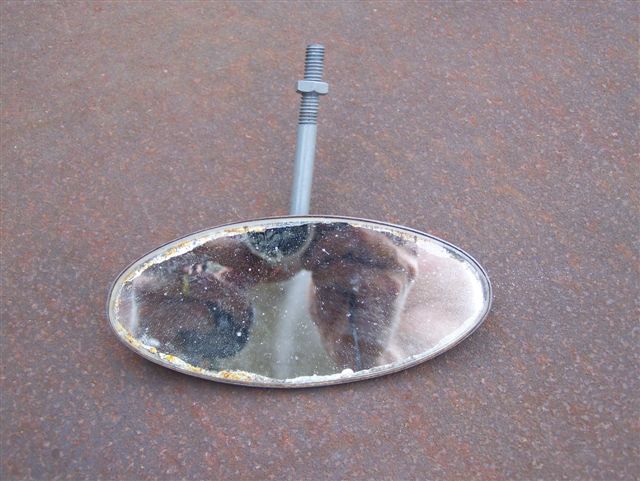

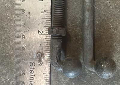

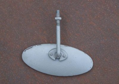

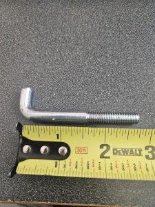

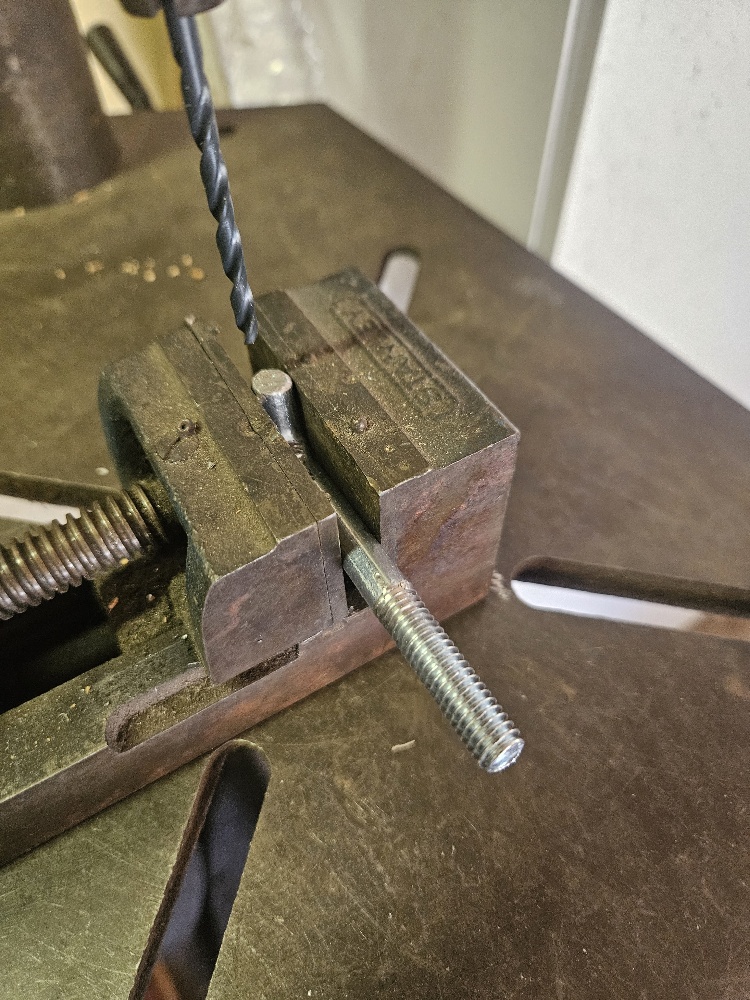

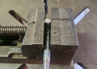

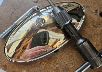

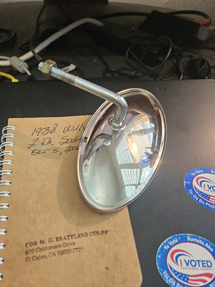

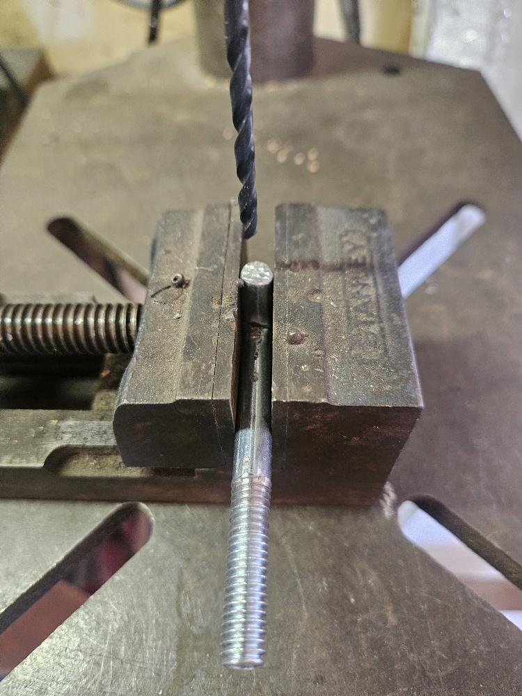

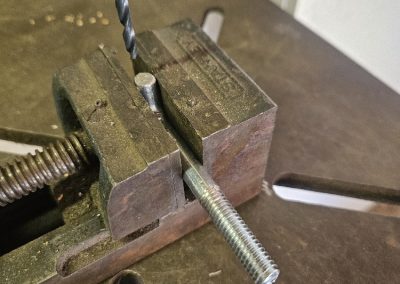

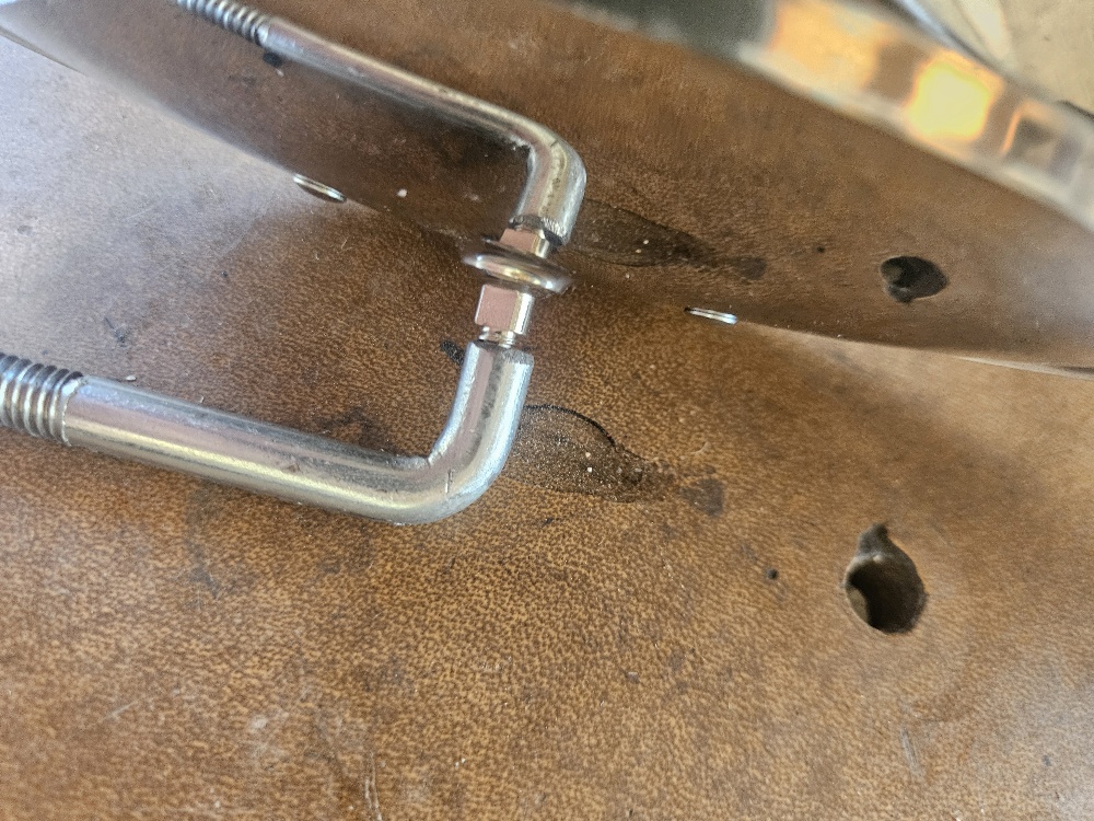

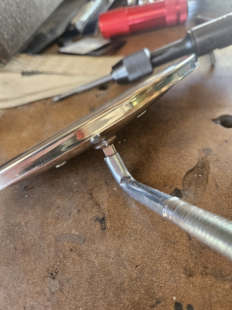

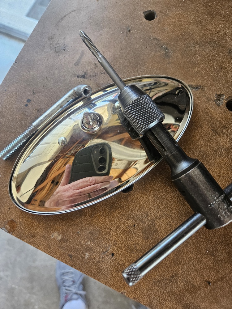

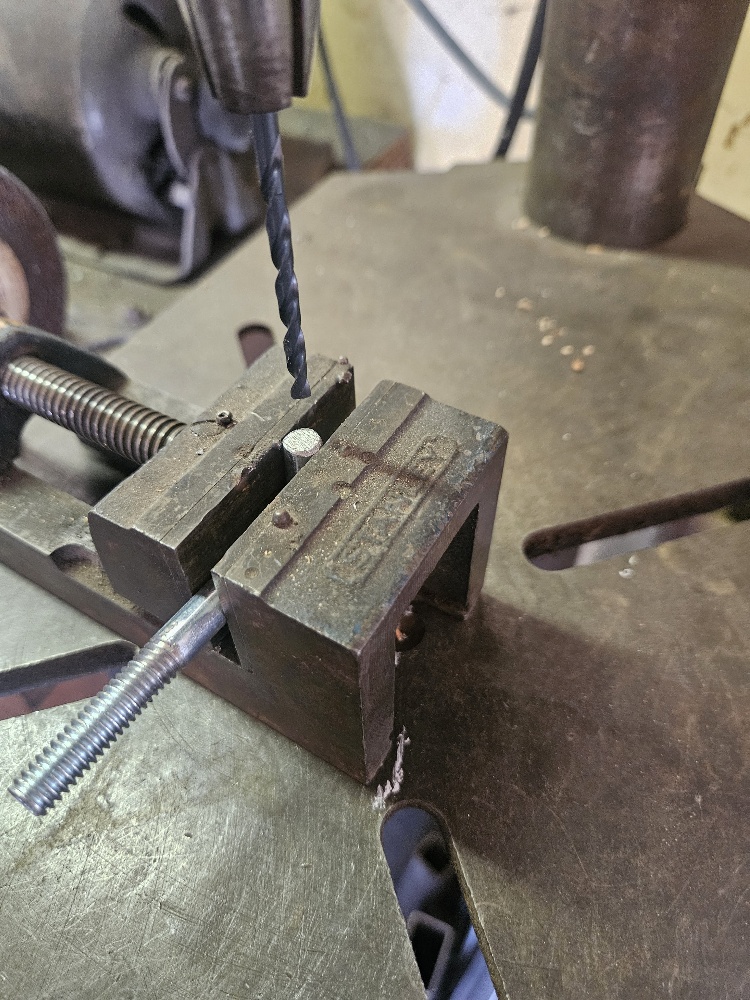

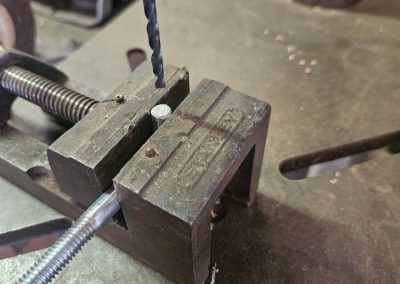

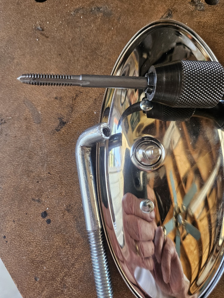

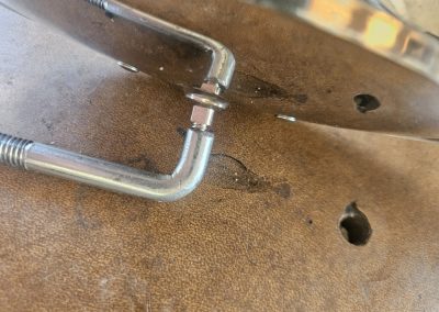

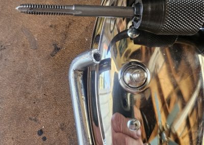

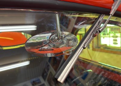

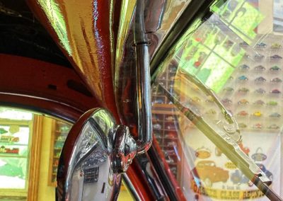

if you need to make a rear view mirror stem mount a 3 1/2 inch long stainless or ordinally bolt bent 90 degrees at approximately 3 inches from the thread end and then thread the end of the 90 degree short piece to connect to the Speedway Mirror or a mirror of your choice which offers the right back attachment so the mirror can be adjusted.  I used a chromium 5/15-18 3 1/2 inch bolt to quickly make the below Rear View Mirror Mount Bolt Stem. I added another 3/4 of an inch thread, but would need to add another 3/4 inch worth to match the thread length on the original Willys Rear View Mirror Stem Bolt.  Starter guidance

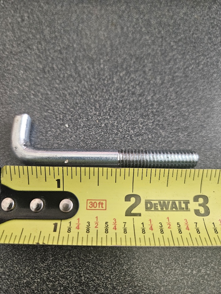

1937-42 Willys Rear view Mirror 90 Degree Ball Mirror Mount Bolt Stem
The bolt is a 5/16-18 Course Thread, 3 Inches long to the center of the 90 Degree Bend and original Willys Mirror Mount Ball.  There is approximately 2 1/4 inches of 5/15-18 thread on the Mirror Mount 90 Degree Bolt.

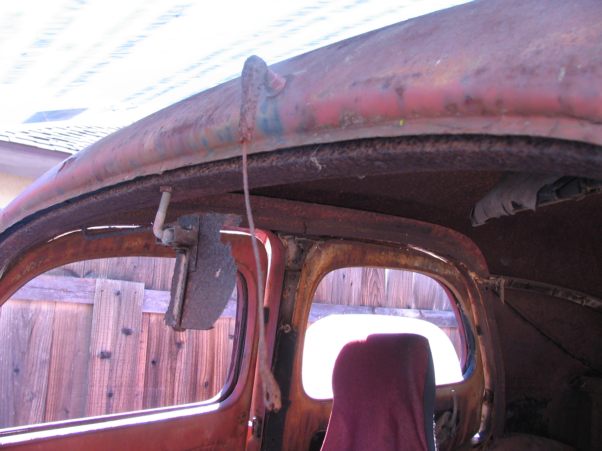

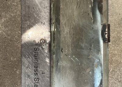

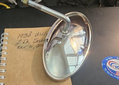

This simple 90 Degree Ball Mirror Mount Bolt was used on all 1937-42 Willys Rear View Mirrors. 1937-1940 Willys Rear View Mirrors Willys offered a large rectangular, 5 inch x 2 1/2 inch rear view mirror.  Beginning in 1941 and 42 Willys went to a simple oval shaped Rear View Mirror.

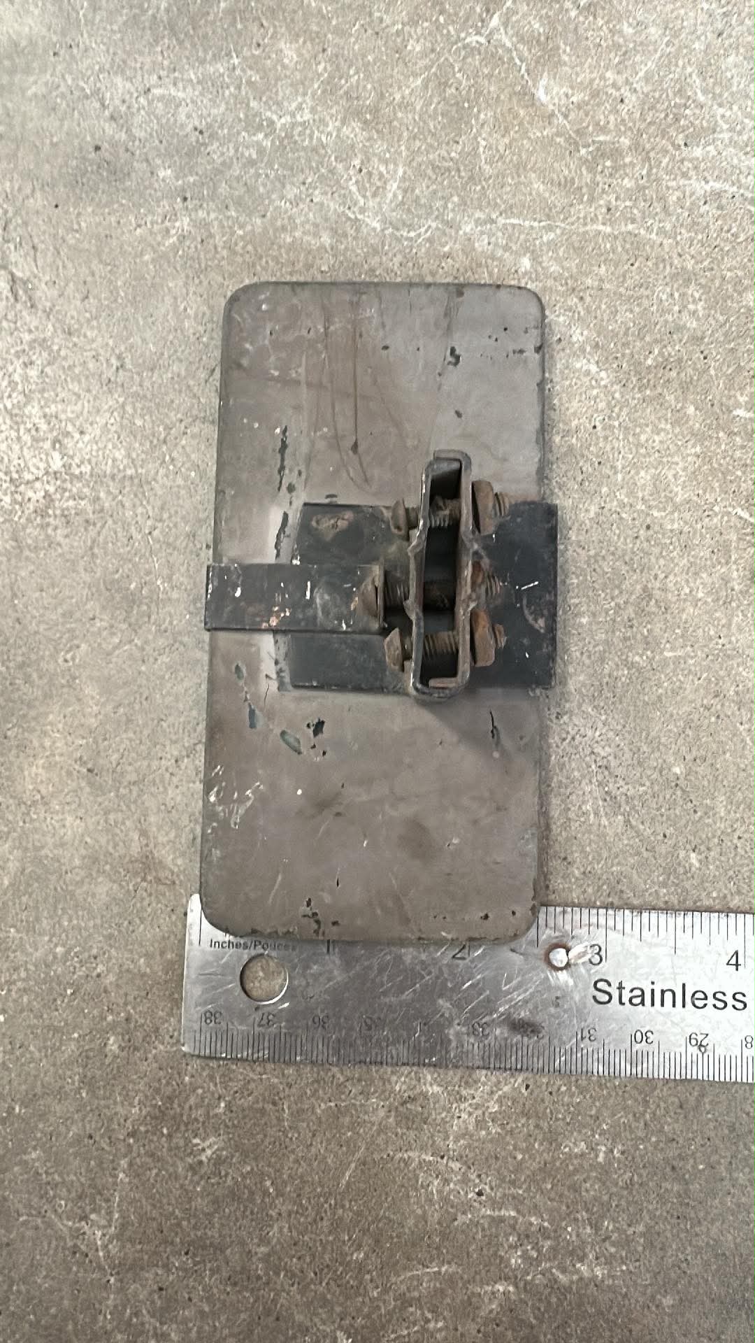

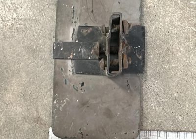

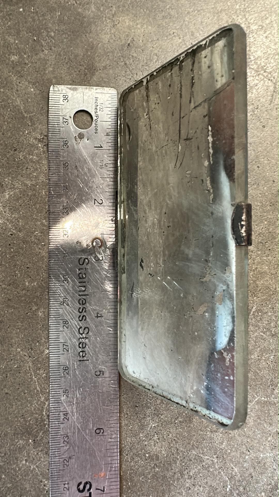

1937-40 Willys Rectangular Rear View Mirror

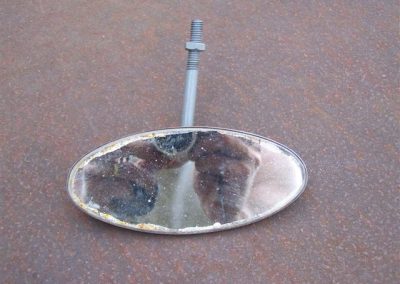

This simple 90 Degree Ball Mirror Mount Bolt was used on all 1937-42 Willys Rear View Mirrors.  for 1937-1940 Willys rear view Mirrors Willys offered a large rectangular rear view mirror.  Beginning in 1941 and 42 it went to a simple oval shaped Rear View Mirror. The 1937-40 mirror dimensions were 5 inches x 2 1/2 inches  (rectangle shape).

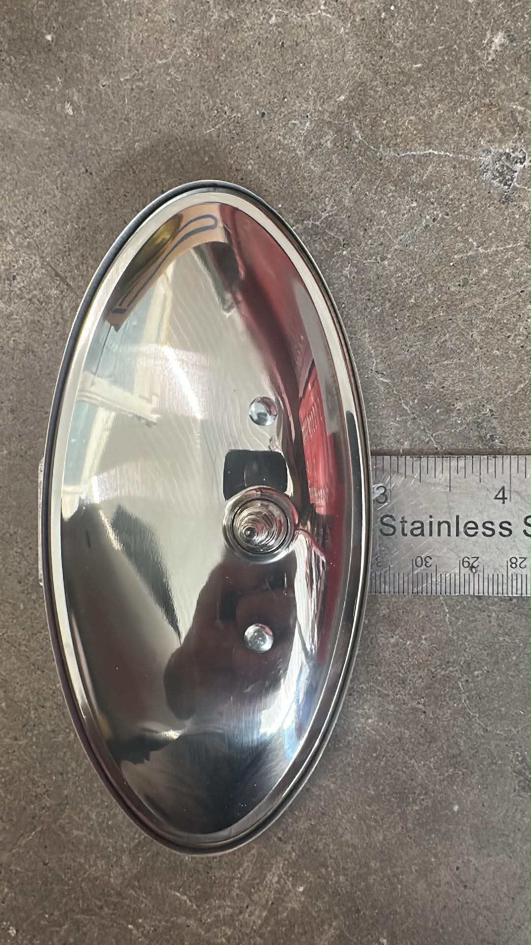

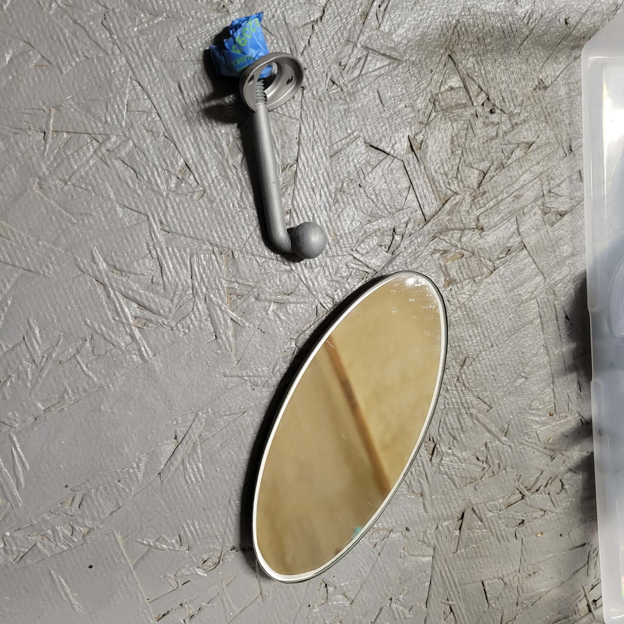

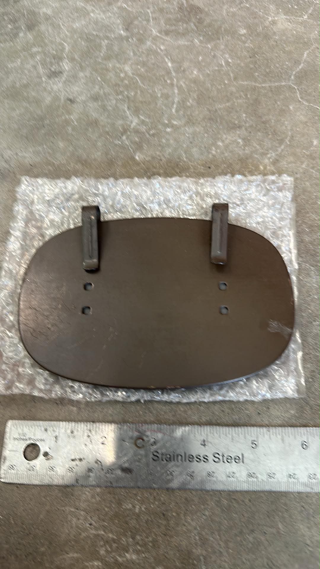

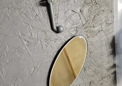

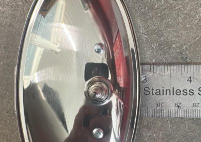

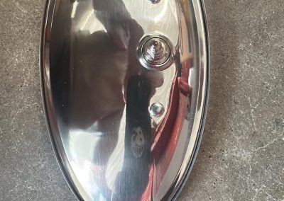

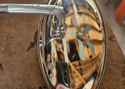

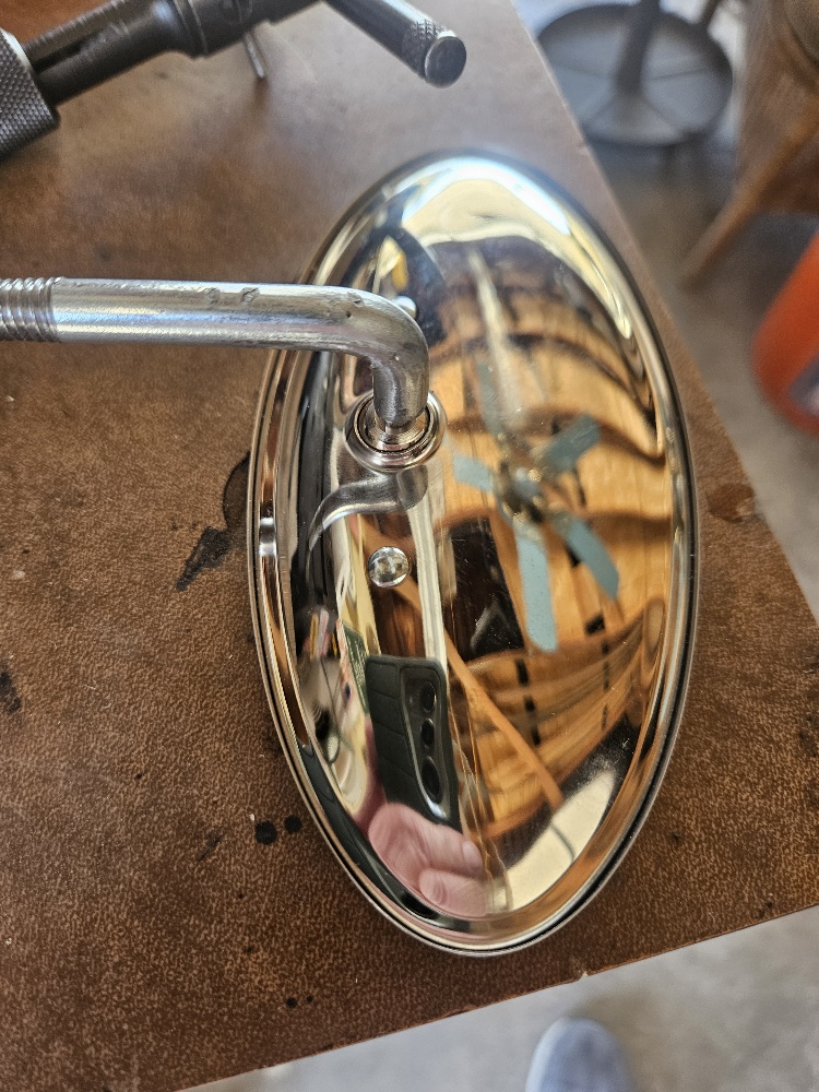

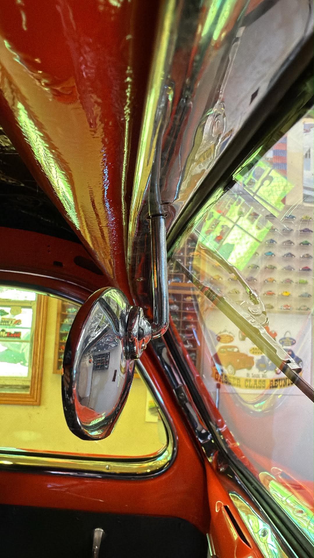

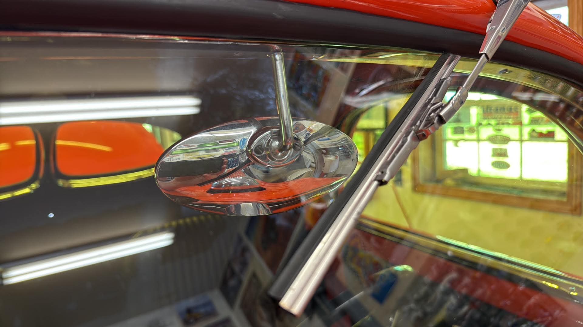

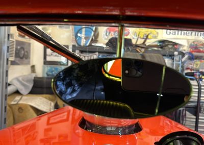

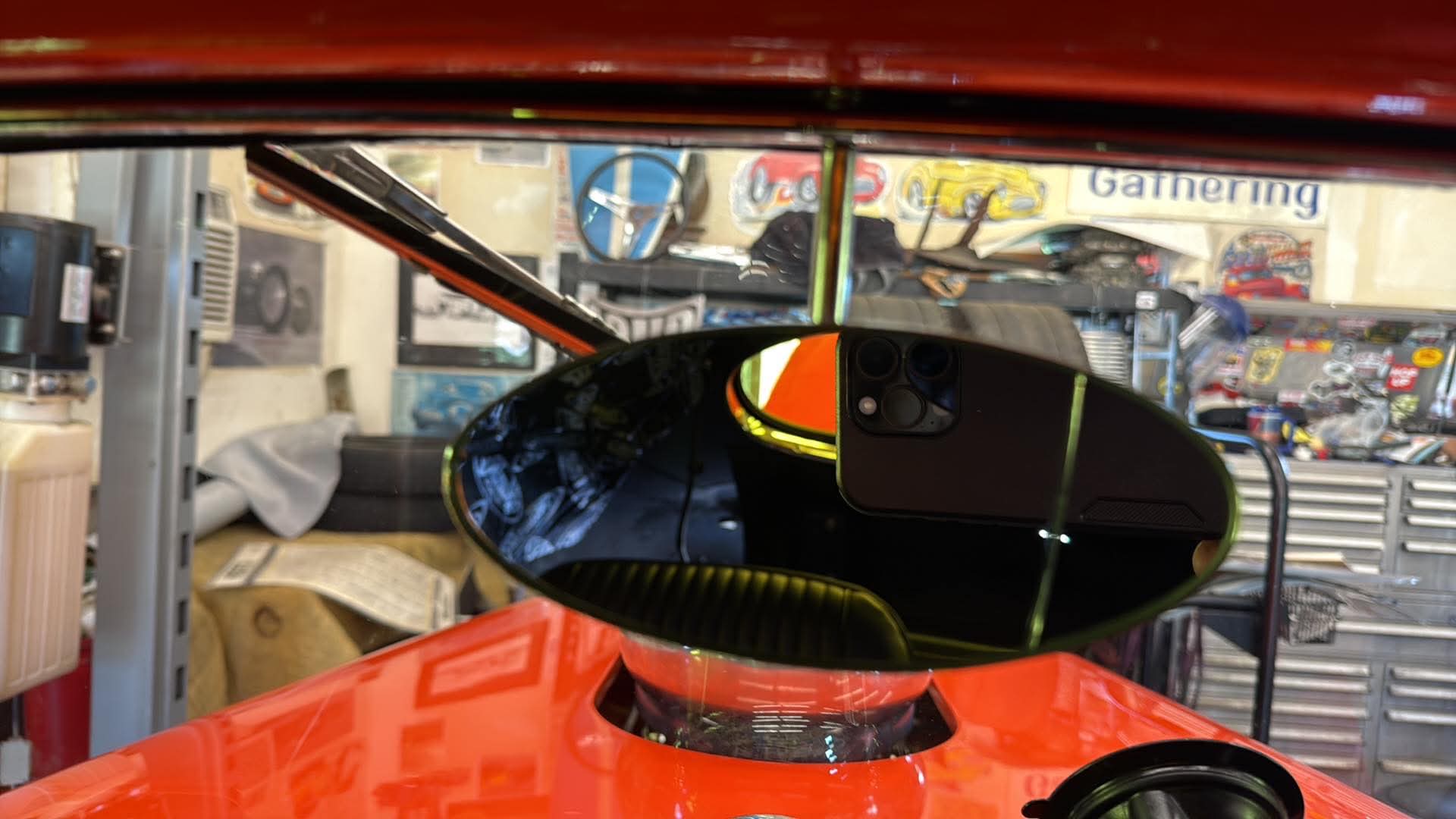

1941-42 Willys Oval Rear View Mirror

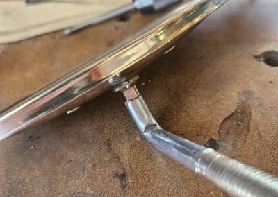

This simple 90 Degree Ball Mirror Mount Bolt was used on all 1937-42 Willys Rear View Mirrors, whether rectangular or oval.

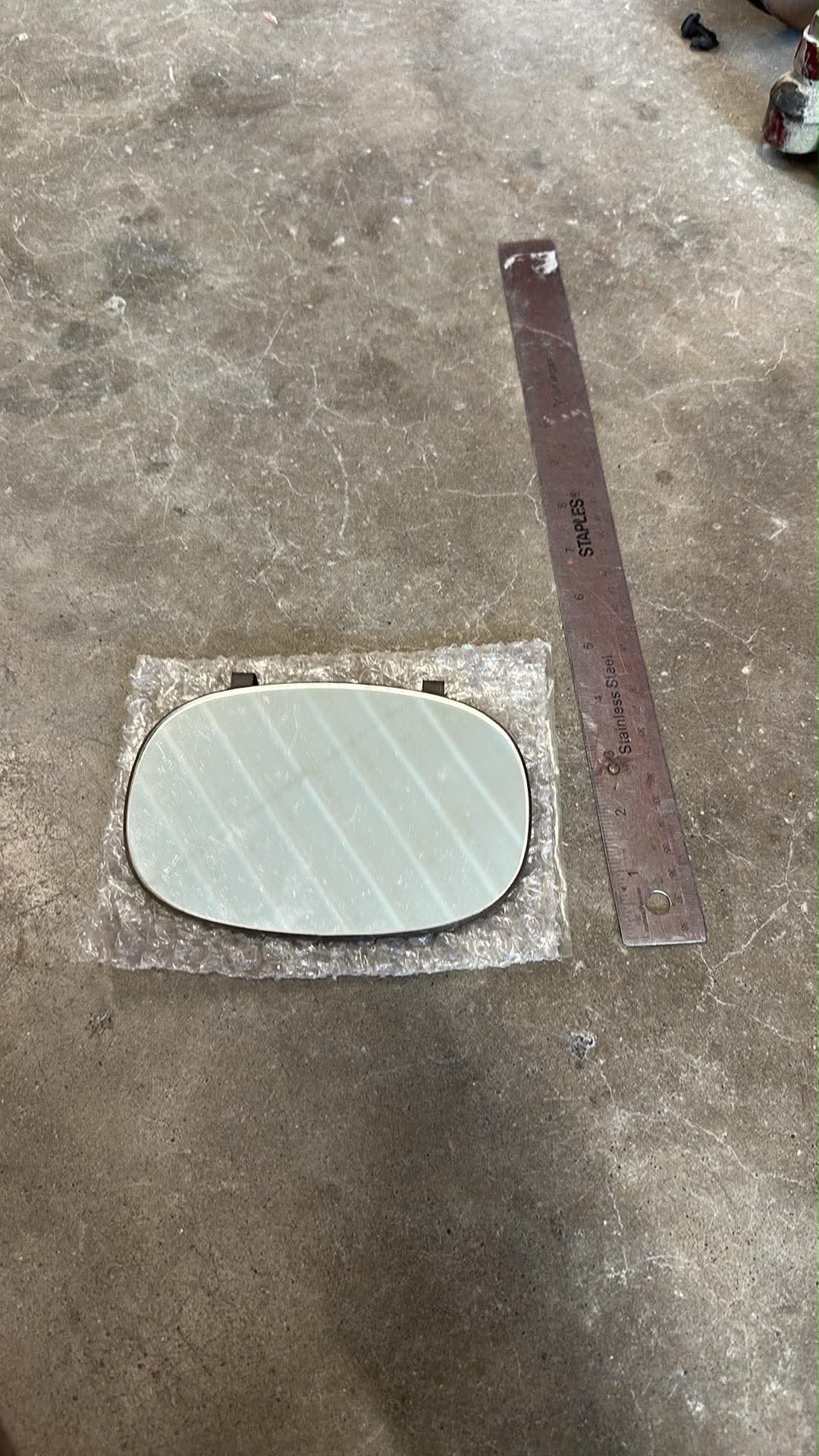

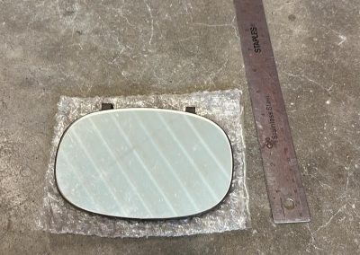

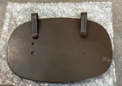

1937-42 Willys Vanity Mirror for the Sun Visor
The simple 1937-42 Willys Vanity Mirror was a clip on affair 5 3/4inches x 4 inches and was normally attached to the passenger side Sun Visor.

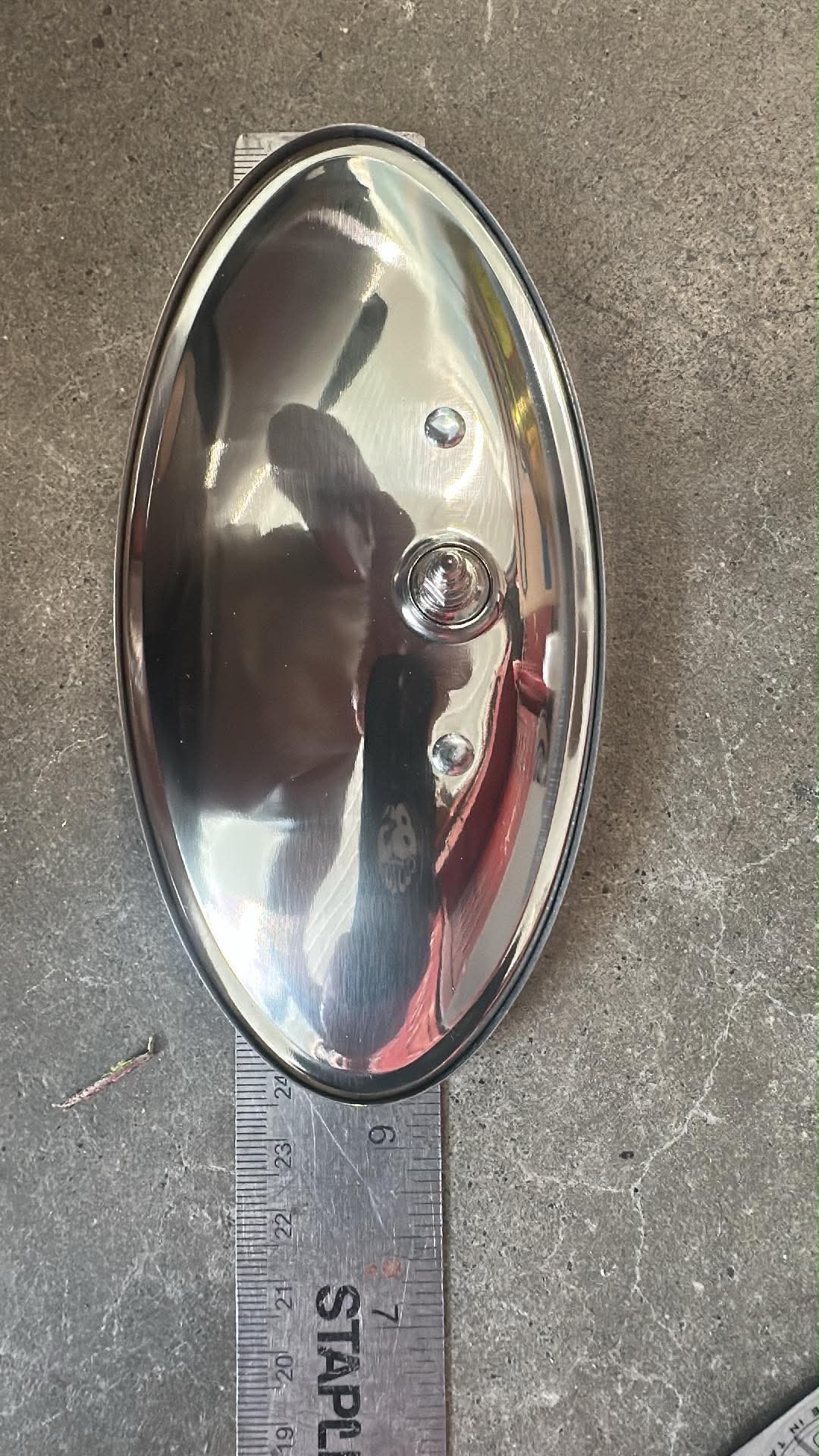

Speedway Stainless Steel Oval Interior Rear View Mirror 910-51225
  • Premium heavy-duty steel construction for consistent performance and reliability
  • Mirror glues onto your windshield, glue NOT included
  • Overall length 5.75″, overall height 2.81″, base diameter .88″
